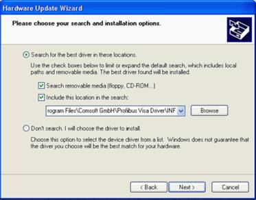

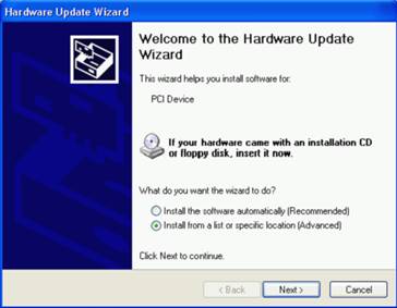

Install the board driver software via the Windows “New hardware”- dialog which should pop up automatically after the board is installed. Select the option to install the driver from the specified directory as shown in Figure 1.
Figure 1: HW Update Wizard
Select the “Comsoft” installation directory for  the driver software as shown in Figure 2. (C:\Program Files\Comsoft GmbH\Profibus VISA Driver\INF)
Figure 2: Select the “Comsoft” Installation directory

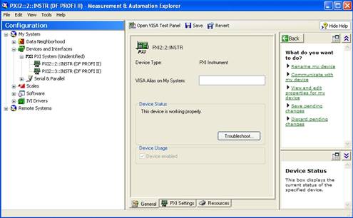

After Hardware and Software Installation open Measurement & Automation Explorer (MAX) and check for proper installation of the DF PROFI II boards as shown in Figure 3.
Figure 3: MAX Devices and Interfaces
Configure an Alias name for all your boards and save the new alias configuration as shown in Figure 4.
Figure 4: MAX Alias configuration

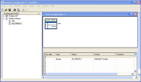

Start “Configurator II” from the Start >> Programs >> Comsoft GmbH >> Profibus Configurator >> Configurator II menu. From the Project Menu choose “New” to create a new bus configuration and drop a DF_PROFI 2 Master board to the configuration window as shown in Figure 5.
Figure 5: Configurator II Master Part

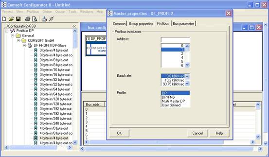

Double-click the Master Icon and configure the master address, baud rate and Profile as shown in Figure 7.
Figure 7: Configurator II Master properties

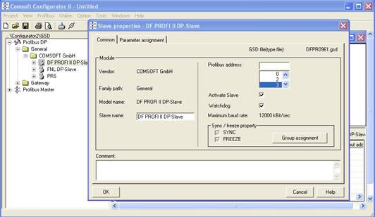

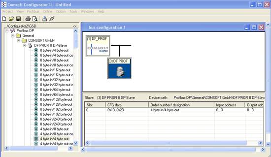

Double-click the Slave Icon and configure the slave address to “3”  as shown in Figure 9 and close the slave properties configuration window again.
Figure 9: Configurator II Slave Properties

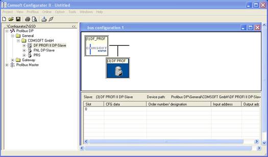

Frome the Slave parameter configuration table drag your slave memory configuration to Slot 0 as shown in Figure 10.
Figure 10: Configurator II Slave memory configuration

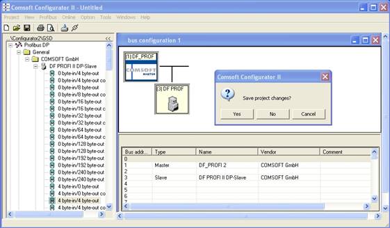

Press the Menu >> “Download” button. The “Project save” dialog appears as shown in Figure 11. Name your project and save it to the configurator projects folder. Wait until the download has finished successfully.
Figure 11: Configurator II configuration download

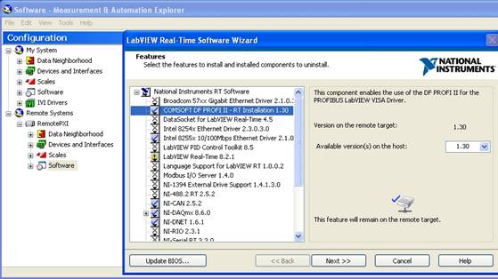

- On your Host, open MAX and find your remote target, as shown in Figure 12.
- On your remote RT target you need to install the “Comsoft” RT driver support by using the LV RT Software Wizard.
- Make sure the remote support for NI-VISA 4.2 or later is installed as well.
- Reboot your remote system.
Figure 12: Remote driver installation

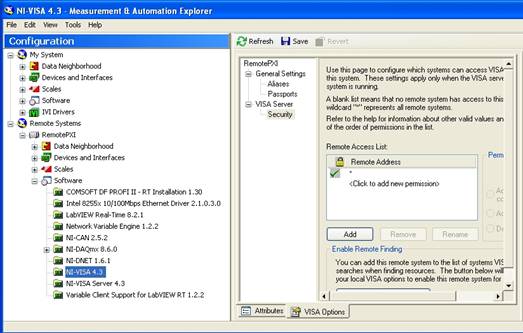

- On your remote RT target go to the “Software” folder and left click to NI-VISA.
- On the right MAX Window go to VISA Options Tab and choose VISA Server >> Security.
- Under “Remote Address “ enter your Remote systems IP address or a wildcard, as shown in Figure 13, so it can be found from your Host.
Figure 13: Remote Server VISA Security
