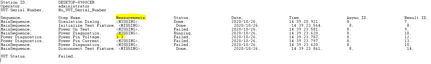

This KB guides how to add Additional Results of each step to the Simple Text Report .
  1. Open the sequence file you want to create a Simple Text Report.
  2. Go to Configure>>Result Processing and check that Simple Text Report is enabled.
  3. Select the step you want to add Additional Results to, and go to Properties>>Additional Results.
  4. Click the Add Custom Result
  5. Input Str("Measurement") for Name and Str(Step.Result.Numeric) for Value to Log.
  6. Open <TestStand Public>\Components\Models\ModelPlugins\NI_SimpleTextReport_LabVIEW.seq
  7. Select Model Plugin-Initialize from the Sequences list.
  8. In Variables, right-click Locals>>ReportColumns and then click Insert Element to add an element.
  9. Enter Measurements for DisplayName and AdditionalResults["Measurement"] for Key.
  10. Save NI_SimpleTextReport_LabVIEW.seq
  11. Go back to your sequence file, test it, and check the report.
Note:
  • If you would like to add the Additional Results for other purpose, the Name provided in Step 5 must tally with the Key in Step 9. For example, Name in Additional Results is given as Str("StationGlobals"), then the Key in ReportColumns element must be AdditionalResults["StationGlobals"].
A new column is created as below, and Additional Results are added. You can add results by doing the same for each step.
