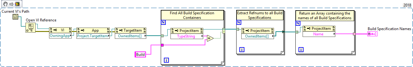

If your VI is used as a pre- or post build action of a build specification, the example above won't work. Instead, you can access the names of the project's build specifications using the Project Path control, as shown in the block diagram below:![](/servlet/rtaImage?eid=ka03q000000lLQz&feoid=00N0Z00000HEWRM&refid=0EM0Z000000WqMP)
