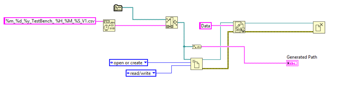

You can also use file I/O constants to build a directory that will log your files to the Application Directory or the Default Data Directory.
