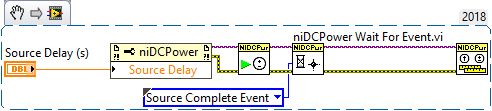

Aside from simply adding a software delay before calling the measure function, there are two ways to add a delay between when the output is enabled and when a measurement is take in Single-Point mode:
- Configure the Source Delay property and add the NI-DCPower Wait for Event VI.
The
Source Delay property configures a delay before the generation of the Source Complete Event. We can add the
NI-DCPower Wait for Event VI as seen in the VI snippet above and configure it to wait for the
Source Complete event. It will be this Wait for Event function that pauses the program in the same manner as the
Time Delay Express VI.
