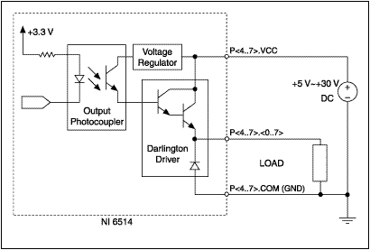

The NI-6512/6514/6516/6518 devices offer digital output lines for sourcing current. The following block diagram shows how the output line is switched and how to connect a load.
Notice that the connection between PX.X and Vcc is made by a Darlington Driver. This driver chip will introduce a voltage drop between its connecting terminals. The drop is not constant and is a function of the current being sourced. The voltage drop will not exceed the following specifications:
Output CurrentMax Voltage Drop
100 mA1.8 V
225 mA1.9 V
350 mA2.0 V

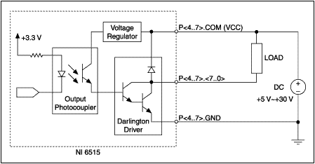

The NI-6513/6515/6517/6519 devices offer digital output lines for sinking current. The following block diagram shows how the output line is switched and how to connect a load.
Notice that the connection between PX.X and Ground is made by another Darlington Driver. This is a different chip but will also introduce a voltage drop between its connecting terminals based on the current being accepted. The voltage drop will not exceed the following specifications:
100 mA1.1 V
200 mA1.3 V
350 mA1.6 V

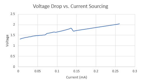

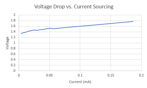

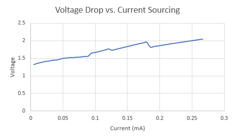

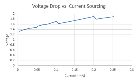

Expected voltage drop graphs for sourcing voltage
Drop when output voltage is 5V.
Drop when output voltage is 10V.
Drop when output voltage is 15V.
Drop when output voltage is 20V.
Drop when output voltage is 25V.
