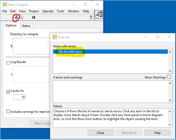

  • My VI has a broken run arrow, but there are no errors in my error list in LabVIEW. Why is it broken if there are no errors?
  • The mass compile tool gets a broken arrow after mass compiling my project, and now I can't fix it.

  • The mass compile tool could also get a broken arrow after mass compiling your project (as shown in the image below) if you have subVIs, dlls, controls or other files that were created in a previous LabVIEW version (for example 2013). If those files were taken from the LabVIEW folders instr.lib or vib.lib of the previous version of LabVIEW, this can potentially cause the broken arrow when mass compiling. To solve this, identify those subVIs or files and delete them from your project, and add the corresponding files from the current LabVIEW version you have installed (for example 2018).
