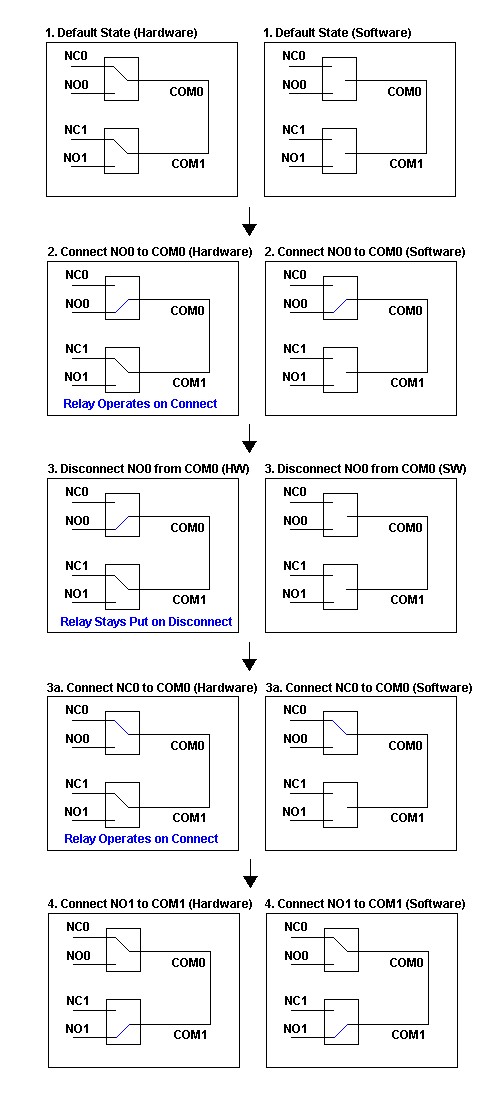

Switch Executive calls into the IVI Switch class driver.  IVI requires all relay connections to be disconnected before a new, different connection can be made.  This doesn't make much sense with SPDT relays, where there is no disconnected state.  As shown below, an SPDT relay is always connected to either the Normally Closed terminal (NC) or the Normally Open terminal (NO).  It cannot be disconnected from both!
To make software work with SPDTs and IVI requirements, IVI-compliant driver software typically stores the state of SPDT relays in a unique and potentially confusing manner.  The example below is comprised of two relays with their COMs connected together (hardwired together).  On the left are the default physical relay states in hardware.  On the right is how IVI-compliant drivers typically characterize the default relay states in software.
As shown above, the default state in software is characterized by no connection.  Although this might be confusing to a user, this characterization is recommended and is done so either the Normally Closed or Normally Open terminals can be initially connected to COM upon the first function call (without first requiring a disconnect call).
The "ability to connect initially without disconnect" feature of IVI-specific driver software (i.e. NI-Switch) results in an inability for NI Switch Executive to determine SPDT hardware states in certain circumstances.  In the end, there exist the exclusion caveats with SPDTs that are discussed in this document.

We can violate the exclusions by performing the following sequence:
  1. Starting from our default state
  2. Connecting NO0 to COM0
  3. Disconnecting NO0 from COM0
  4. Connecting NO1 to COM1
This creates the following hardware and software states.
As shown above, on Step 4 the software state does not detect the excluded route is created, but the hardware state is now in the undesired state! This sequence of connections has violated the exclusion. Note that step 3, disconnecting NO0 from COM0, is the step where NI Switch Executive loses the required hardware state.
  1. The Solution
Note that if a step in inserted between step 3 and 4, connecting NC0 to COM0, then NI Switch Executive does not lose the required hardware state and the exclusion is caught (not violated).
This is the cautionary use case that is required to prevent problems when using SPDTs: Always Connect a SPDT relay immediately after a Disconnect.
