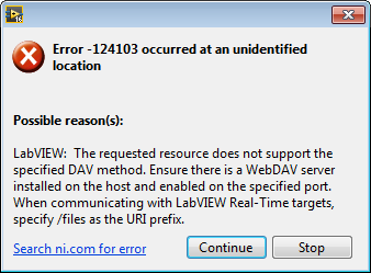

When using LabVIEW Real-Time, I receive the following error:
Error -124103 occurred at an unidentified location
Possible reason(s):
LabVIEW: The requested resource does not support the specified DAV method. Ensure there is a WebDAV server installed on the host and enabled on the specified port. When communicating with LabVIEW Real-Time targets, specify /files as the URI prefix.
This error code is generated if the /files URI prefix is not added for Real-Time targets when using the WebDAV Put VIs.
To resolve this error, simply insert the /files URI prefix as shown below:

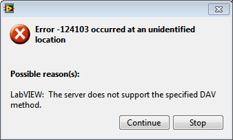

  • In LabVIEW Real-Time Module 2013 and 2013 SP1, you will observe a less verbose version of this same error, but the solution is the same.
