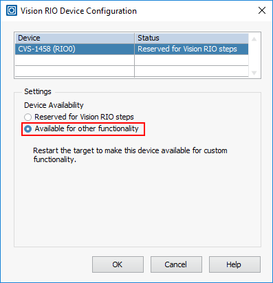

By default, when running VBAI on a Real-Time target, such as an NI Industrial Controller or Compact Vision System, VBAI uses a default FPGA profile to give the user access to the I/O pins on their device using the Vision RIO steps. In order to do this, VBAI opens a reference to the FPGA. In order to run a custom FPGA VI, you must configure VBAI to allow other functions to access the FPGA:
  1. Open a VBAI inspection in configuration mode on your Real-Time target.
  2. Go to the Communicate tab in the functions palette.
  3. Click on Read/Write I/O (Vision RIO) to configure a new Vision RIO step.
  4. In the step configuration, click Configure.
  5. In the Vision RIO Device Configuration window, choose the option Available for other functionality and click OK.
  1. Once you have configured this, you can cancel the Read/Write I/O (Vision RIO) step.
  2. In order for this change to go into effect, restart your Real-Time controller.
You should now be able to add a Run LabVIEW VI step that calls a VI that opens an FPGA reference.
Either Vision RIO or a custom FPGA VI can use the FPGA, but not both at the same time. By configuring the Real-Time controller's FPGA to be available to other functionality, it is no longer available for use in Vision RIO steps. If you need to interact with the device's I/O channels, you can continue to do so inside of your custom FPGA VI. Otherwise, you can revert back to using the FPGA for Vision RIO steps by choosing the Reserved for Vision RIO steps option in the window shown above.
