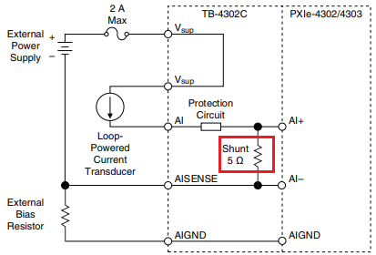

Does the NI TB-4302C have the internal shunt resistor? If yes, what is the value?
The front-mount terminal block for the NI PXIe-4302 and PXIe-4303 has a 5 Ohm built-in shunt resistor.
