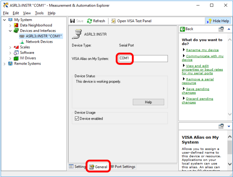

Normally, Measurement & Automation Explorer (MAX) will automatically assign COM1, COM2, and LPT1 as aliases to ASRL1::INSTR, ASRL2::INSTR, and ASRL10::INSTR respectively. These ports will then show up in MAX and in the VISA Resource Name Control as COM1, COM2, and LPT1. If these VISA aliases have been modified by another user, each port under "Devices and Interfaces" will show up with its new alias followed by the binding port in parentheses. In comparison, the VISA Resource Name Control in LabVIEW displays only the VISA alias. For example, the first serial port may show up as ASRL1(COM1) in MAX, but would show as ASRL1 in LabVIEW.
In order to change the VISA alias, simply right-click on the port in MAX under Devices and Interfaces»Ports and select Rename. You can also change the alias by opening the General tab where you can rename the port bound to COM1 as "COM1".  It will now read as COM1 in both MAX and LabVIEW. If you rename it as MyPort, it will show up as MyPort in MAX and as MyPort in LabVIEW. Once you have renamed the port, you must save the alias in order for it to show up in LabVIEW.
