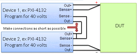

Measurements made using remote sense with cascaded SMUs will still require 4-wire connections for each SMU. However, the connections will be made as seen in Figure 2.
Figure 2. Remote Sense Connections when using two SMUs, here two PXI-4132s.

- When cascading SMUs to increase the voltage output, the Out+ of Device 2 is jumped or tied to the Out– of Device 1 as illustrated in Figure 2. In this same way, the Sense+ of Device 2 is jumped to Sense– of Device 1. However, in order for remote sense to measure the voltage being supplied by the Out+ and Out– terminals of that device, the sense jumper must be tied to the output jumper, as seen in Figure 2.

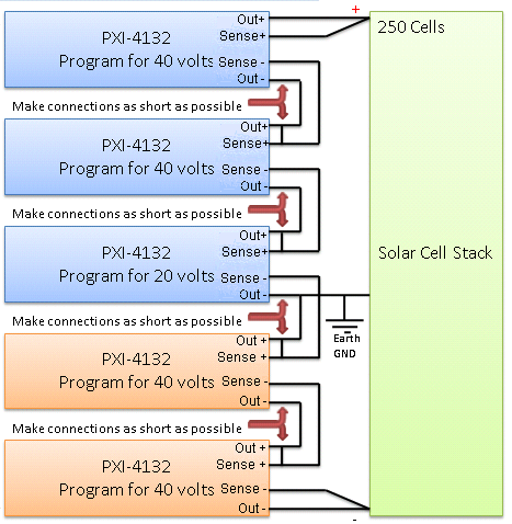

- When cascading more than two SMUs, you will need to make sure that the total voltage being supplied remains within the Isolation or Channel-to-Ground Specification for that model of SMU. For instance, the voltage supplied by cascaded NI PXI-4130 SMUs must remain within ±60V from Ground. For the NI PXI-4132, the voltage must be within ±150V from ground. An example of how to connect the remote sense leads and how to ground the cascaded SMUs can be seen in Figure 3 below.
- Additionally, if you cascade more than two SMUs, ensure that the connection setup between modules is consistent throughout your system. In Figure 3, notice that the length between the sense lines and the voltage lines is in the same location for every module.
Figure 3: Remote Sense and Ground connections when cascading more than two SMUs
