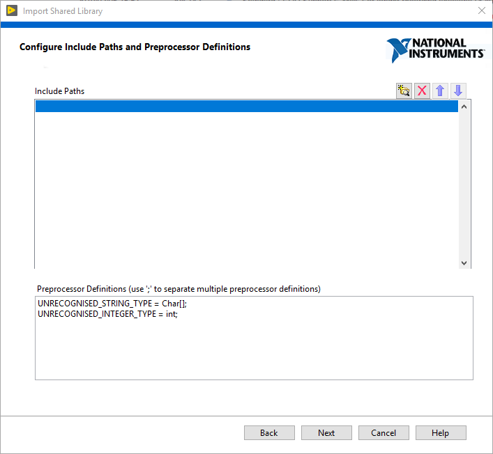

I'm importing a dynamic link library (DLL) into LabVIEW using the Import Shared Library wizard and some functions cannot be wrapped due to undefined symbols, how can I fix these?
What do stdint.h datatypes such as uint64_t etc. correspond to in LabVIEW when importing DLLs?
When using the Import Shared Library wizard, LabVIEW will not recognise some non-standard datatypes. To fix this, you need to specify which LabVIEW recognised types equate to the unrecognised data types in the Preprocessor Definitions (go back from the warnings screen) , as demonstrated below:
Once all unrecognised datatypes have been specified, LabVIEW will be able to wrap all of the functions in the library.
