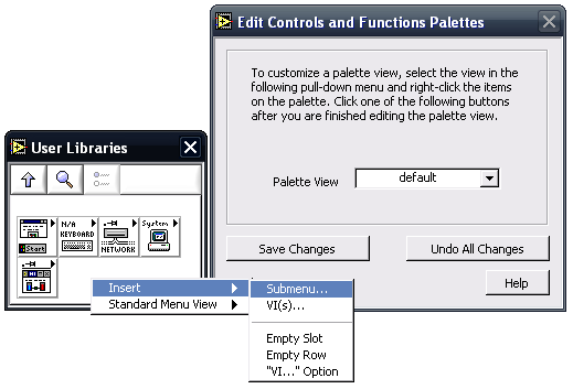

LabVIEW 7.x
  1. Go to Tools»Advanced»Edit Palette Set…
  2. Three windows will pop up: (a) the Edit Controls and Functions Palettes window, (b) the Controls window, and (c) the Functions window.
  3. Right click in empty space within the sub-palette and select Insert»Subpalette... or Insert»VI(s)...
  4. Select the link to an existing menu or VI file (.mnu or .vi) and click OK.
  5. Select Save Changes and exit and re-enter LabVIEW.
LabVIEW 6.1 and earlier
  1. Pin the function palette to the block diagram or front panel by clicking on the pin in the upper left hand corner.
  2. Click on Options (the icon does not appear unless the function palette is tacked and looks like two bullets).
  3. Select Edit Palettes.
  4. Within the Function Palette, navigate to the location where you would expect the icon to appear.
  5. Right click in empty space within the sub-palette and select Insert»Submenu (as shown below).
  1. Select the link to an existing menu file (.mnu) and click OK.
  2. Select the dir.mnu.*
  3. Select Save Changes and exit and re-enter LabVIEW.
