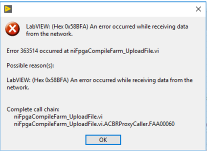

Error 363514 when Compiling Locally
Updated Apr 14, 2025
  • LabVIEW FPGA Module
When I try to compile my FPGA code locally, I get the error below.
Turning off firewalls and antivirus during the compilation, will remove the error.
