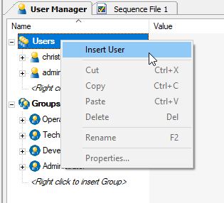

If you have another user account with administrator privileges, you can add back in the default "administrator account." Do so by going to TestStand Sequence Editor >> View >> User Manager. Once you're in User Manager, right click on Users and select Add User.
Once you've added the new user, change the name to "administrator."

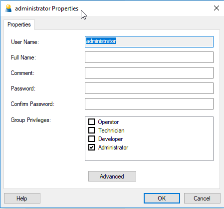

Next, right click on the new user "administrator" and select Properties. Under Group Privileges, select Administrator and hit OK.
