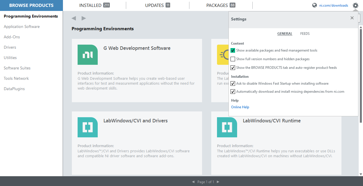

  2. Install the most current supported version of your device driver which is compatible with your version of LabVIEW, and be sure to include support for your specific LabVIEW version when prompted. Take into consideration that previous versions have a different process to add DAQmx VI palettes through NI Package Manager.
    • First, navigate to the settings icon and facilitate the "Show available packages and feed management tools"image.png
    • Once this option is selected navigate to the packages tab and select the NI-DAQmx Support for LabVIEW X.Ximage.png
