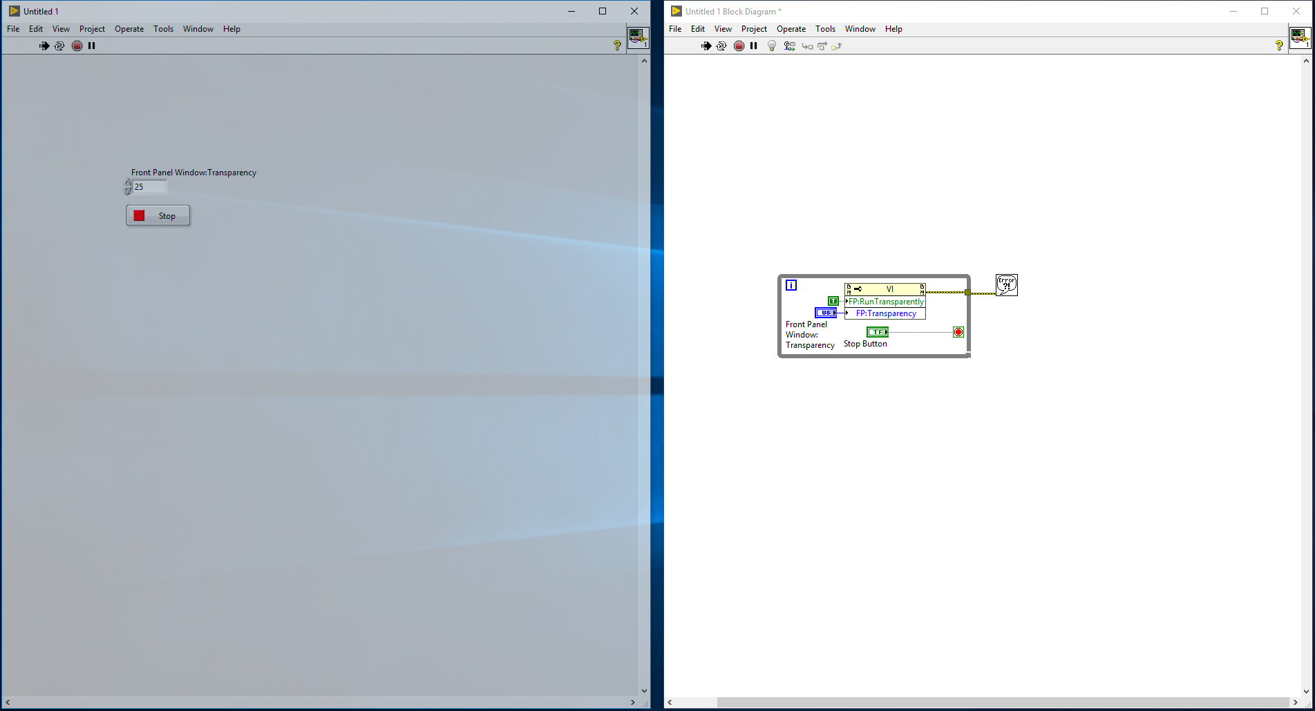

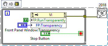

This is Possible in LabVIEW. please see this VI snippet.
This snippet of code consists of a while loop containing a property node using the properties; "FP:RunTransparently" and "FP:Transperency."

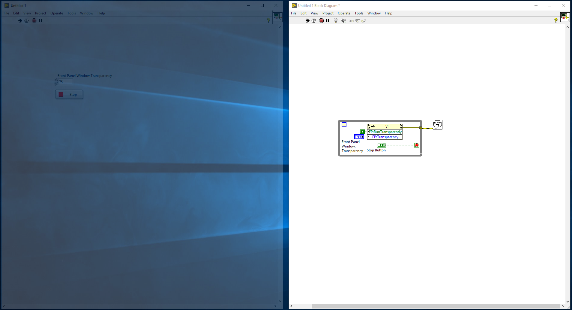

Looking at the screenshots, the transparency is on a sliding scale where U8 control = 0 is no transparency and U8 control = 100 is full Transparency.
![](/servlet/rtaImage?eid=ka00Z0000011FpZ&feoid=00N0Z00000HEWRt&refid=0EM0Z000000W7FE)
![](/servlet/rtaImage?eid=ka00Z0000011FpZ&feoid=00N0Z00000HEWRt&refid=0EM0Z000000W7FJ)
