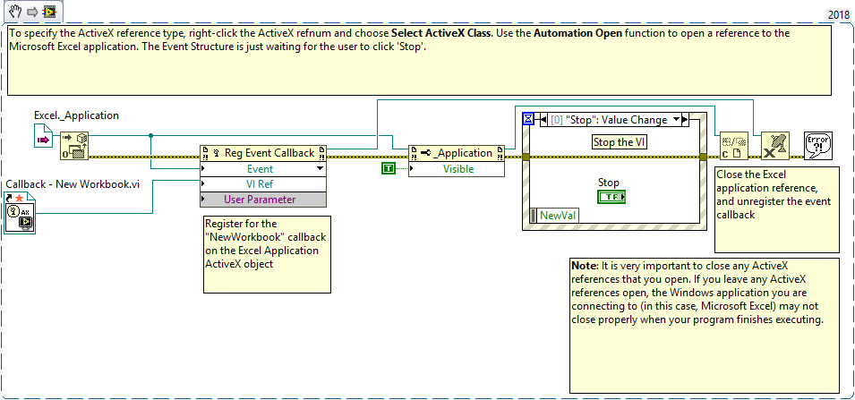

To create an ActiveX automation task, you have to call the Automation Open function and build your task as shown below for the Excel ActiveX Callback Event example:
Depending on the method used, the deployment of the LabVIEW application and the client application is going to be different:
  • When using the DLL of the client application, you will have to deploy the main LabVIEW VI along the DLL since it is called dynamically. This can be done through the application builder by adding your DLL in the always included section of the source files. More information on how to use the application builder can be found here: Distributing Applications with the LabVIEW Application Builder
  • When using an ActiveX automation task, the client application has to be installed on the deployment computer so that the LabVIEW executable can correctly communicate and control the application using ActiveX.
