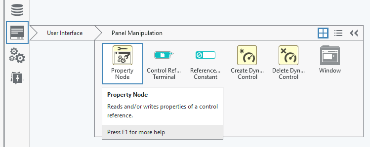

I would like to use the property nodes on LabVIEW NXG but I can't find the function. Does it exist on LabVIEW NXG?
It is possible to use the property nodes on LabVIEW NXG for version 2.0 and later. Go on the Diagram and open the functions relative to User Interface. Then, click on the Panel Manipulation and drag the Property Node on the diagram.
Now, you must create a reference of your object (a numeric control for example) by right-clicking on it and Create reference. Once the reference is created, it is possible to connect it to the property node and then the select the right property, like Disabled for example.
