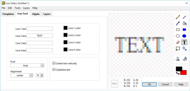

When I add text to my VI icon in the LabVIEW Icon Editor, the texts are blurry if I set the font size to smaller than 10. Text appears normal when the font size is set larger than 11, but then the font size is too big to fit into the Icon.
  • This may occur for some fonts that are more detailed than the default and appear pixelated. To improve visualization, try different fonts including the default Small Fonts.

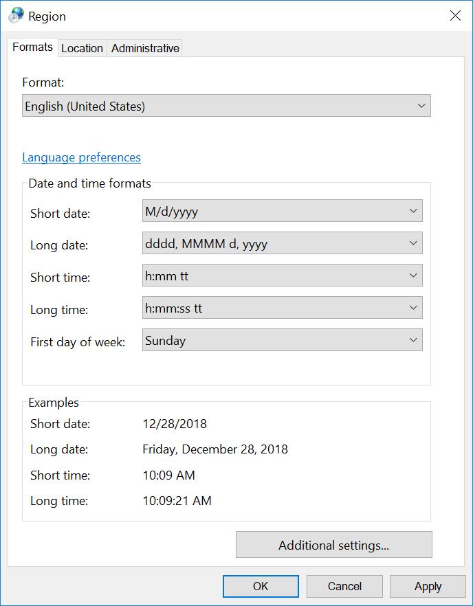

  • Change the Region in Windows
    1. Navigate to Control Panel>>Region>>Formats. Set Format to English (United States) and relaunch LabVIEW.
