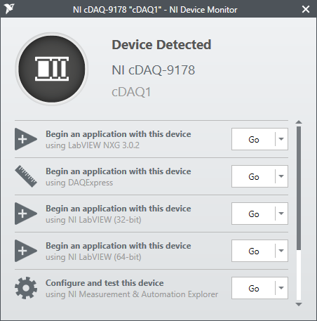

I am deploying an application that uses a USB DAQ device and everything works fine. However, every time I connect the USB DAQ device, the NI Device Monitor popup window shows up with a Device Detected message
This behavior is acceptable (even desirable) in a development environment, but not in a deployed system. How do I disable the NI Device Monitor popup message?

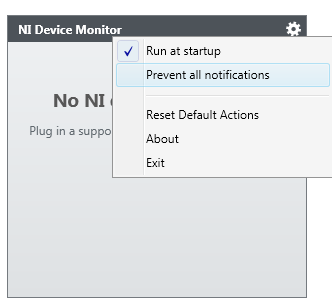

Disable the NI Device Monitor Notifications
This option will disable the popup message but allow using the NI Device Monitor manually.
1. Open the NI Device Monitor from the Windows system tray.
2. Click on Settings.
3. Enable the Prevent all notifications option.
Prevent the NI Device Monitor from Running
This method will permanently prevent the Device Monitor from running, even after reboots.
3. Disable the Run at startup option.
The NI Device Monitor can be started again by navigating to Start >> Programs >> National Instruments >> NI Device Monitor.
