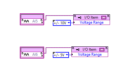

I would like to set the range of two or more analog input channels of an sbRIO-9627 CompactRIO Single-Board Controller differently. Is it possible, or do all ranges have to be the same at the same time based on a global setting?
You can program the input range for each AI channel independently on the sbRIO-9627 using FPGA IO Property Nodes:
