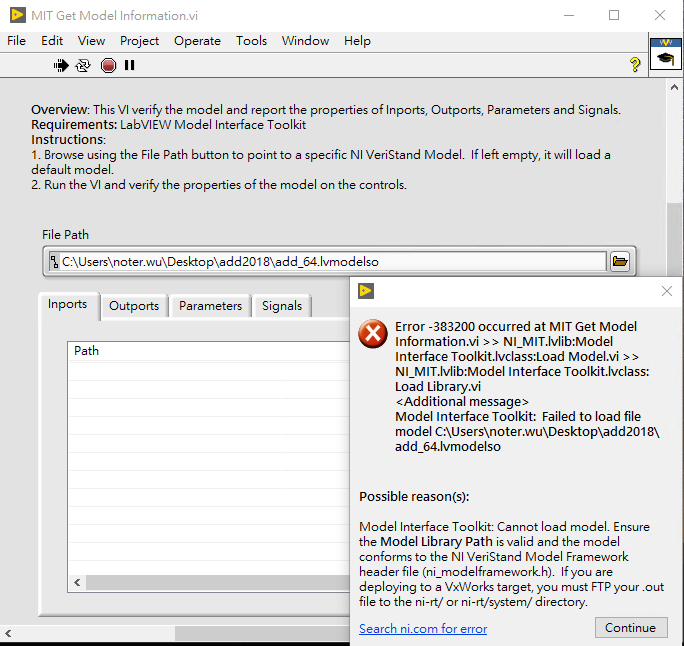

Why I am getting the Error -383200 running the MIT Get Information.vi with .lvmodelso file in Windows machine that was made for Linux x86.
Please follow the steps below.
  1. Make sure the cRIO already has the Model Interface Toolkit installed there. (For installing the Model Interface Toolkit it is necessary to go at Custom Installation).
  2. Create a new LabVIEW Project and drag the MIT Get Model Information.vi example under the cRIO.
  3. Deploy the RT VI.
  4. Transfer the .lvmodelso file in the cRIO.
  5. Use the folder path where the .lvmodelso was storage.
  6. Run the example.
