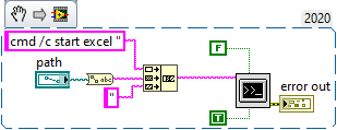

Opening Excel from LabVIEW
To open Excel from LabVIEW, the System Exec VI can be used. This executes the same system command that can be used in Windows Command Line to open Excel.
