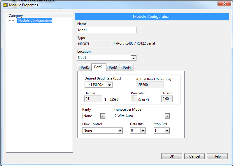

While programming in FPGA Mode, you can configure the baud rate of each port programatically with the FPGA I/O property node.
In the property node, click the element and select Baud Rate Divider and Baud Rate Prescaler. All possible baud rates are determined by the following equation:
Baud Rate = 3686400 / (Divider * Prescaler)
Divider can be between 1 and 65535
Prescaler can be 1 or 4.
Non-Programatically Setting the Baud Rate
The baud rate for each port can also be configured in the Module Properties.
  1. Right click on the 987x module in the Project Explorer and select Properties.
  1. Check and set the Desired Baud Rate with Divider and Prescaler values. The Baud Rate is calculated as per the above equation.
  • Note that if an entered Desired Baud Rate is outside of the possible baud rates per the above equation, the Actual Baud Rate will be a different value with a %Error.
