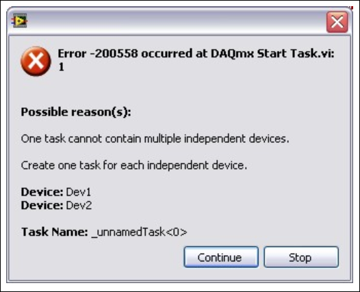

Why do I receive Error -200558 when I try to use a task that contains multiple DAQ devices?
One task cannot contain multiple independent devices.
Create one task for each independent device.

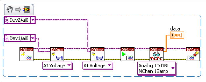

Though a DAQmx task can bundle multiple channels together, it is usually restricted to accessing only one hardware device (with the exception being Compact DAQ, S Series, X Series, and DSA modules).  If you try to combine multiple devices into one task, as shown below, you will receive this error because each device will have its own sample clock and a task can only time off of one sample clock.

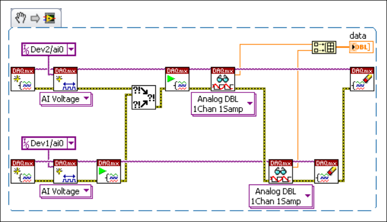

Instead you should use a separate DAQmx task for each device, as shown below.
