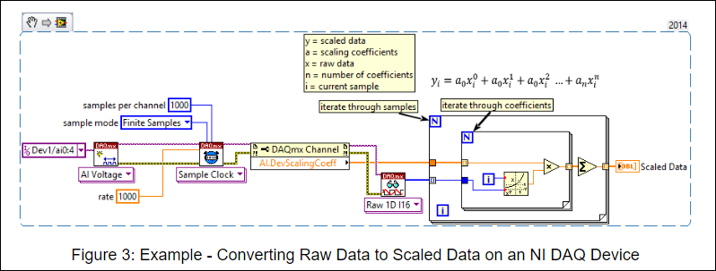

Manually Convert Binary Data to Scaled Data
Using the Device Scaling Coefficient property node, you can convert the binary data to scaled data using a setup similar to the one below.
