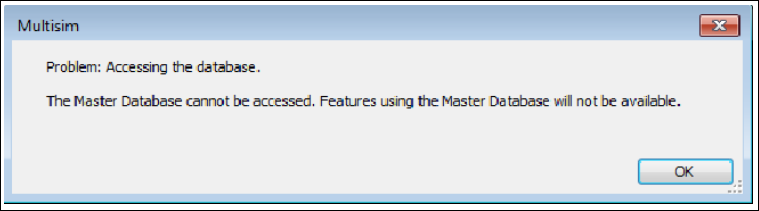

When I launch Multisim I get error messages saying there was a problem opening the database. Multisim then opens fine, but I cannot select any parts from the databases, they are empty.
The error message is similar to this one (it might say Master, Corporate or User):
Problem: Accessing the database.
The Master Database cannot be accessed. Features using the Master Database will not be available.
Why is this happening and how can I get this fixed?
