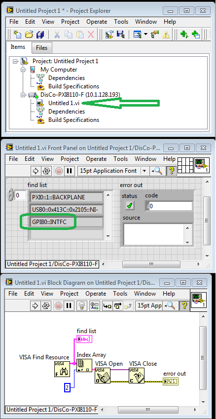

I am seeing an error from VISA Configure Serial Port VI that runs in the initialization state of my VeriStand Custom Device. The error code is -1073807192 VISA: (Hex 0xBFFF00A8) Access to the resource or remote machine is denied. This is due to lack of sufficient privileges for the current user or machine.
The VISA address of the COM port should not include the IP if the code is running on the target. Make sure that your VISA address looks similar to the image below and does not include an IP address:
In the example above if you use the address GPIB0::5::INSTR instead of visa://169.254.104.28/GPIB0::5::INSTR then the error will go away.
