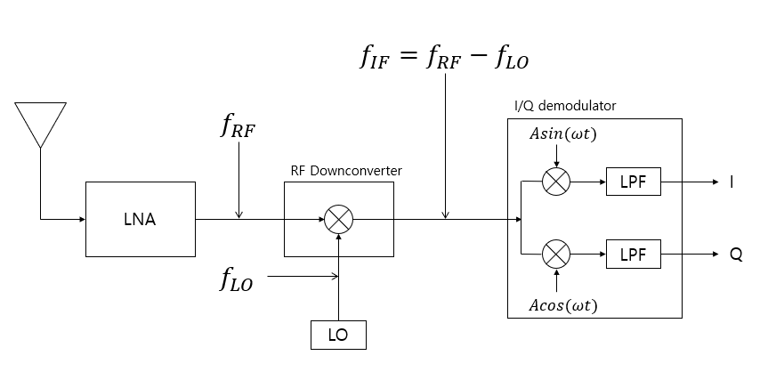

1. Heterodyne Receiver
Generally, a heterodyne receiver has the structure shown in the figure 3 below. Where w is the angular frequency. The frequency of the mixer is included according to the following equation.
Angular Frequency (w) = 2*pi*Oscillator's Frequency (f)
Figure 3. Heterodyne Structure
There is a stage called a IF, which acts as a buffer in a kind of frequency band conversion. After this process, the IF band signal is passed to the IQ demodulator circuit and demodulated into the IQ signal.
In a heterodyne receiver, it has one or more RF downconverter circuitry. If the IF signal stage is more than two stages, this is sometimes called a super heterodyne receiver. Between the IF stages, a BPF is required because the unintended RF signals from the mixer must be removed.
