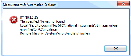

Missing NI-PAL File When Installing Software To Real-Time Controller
Updated Dec 28, 2023
  • PXI Controller
  • LabVIEW Real-Time Module
When I try to add software to my Real-Time controller I receive an error that says I am missing file in the NI-PAL file path.
NI-PAL is installed with DAQmx Drivers when the LabVIEW Real-Time Add-On is installed. Ensure that the software has been installed in the proper order according to this article.
