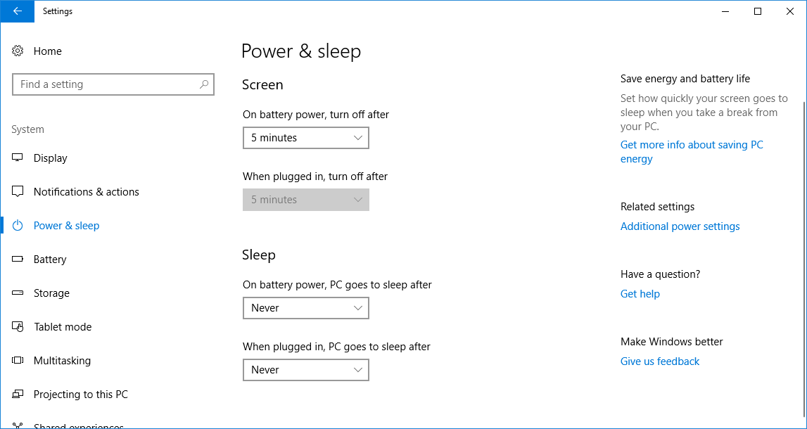

For Windows 10:
Go to Windows Settings>>System>>Power & Sleep and under Sleep, set both of the drop down boxes to Never as shown below:
