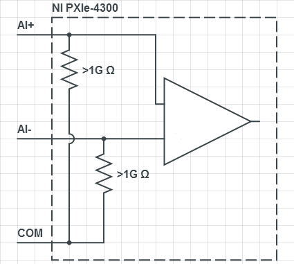

According to the the PXIe-4300 Specifications Manual , the input impedance will be different depending on whether the device is on or off. This is due to protection and signal conditioning circuitry that is only active when the device is on.
When on, the PXIe-4300 has over 1 GΩ input impedance between AI+ and COM, and between AI- and COM. As shown in Figure 1 below.

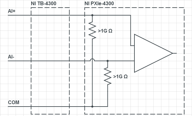

The TB-4300 is a non attenuating feed-through terminal block. It has no effect on the input impedance of the device, as shown in Figure 2 below.

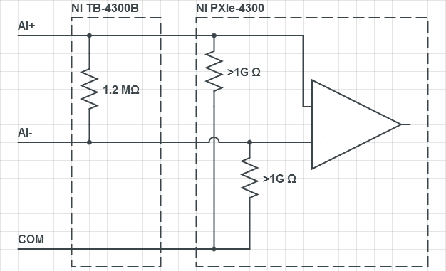

The TB-4300B is an attenuating terminal that has a 1.2 MΩ impedance between the AI+ and AI- pins as shown in Figure 3 below. This terminal block has no effect on the impedance of the NI PXIe-4300 impedance between AI+ and COM or AI- and COM.
There’s no active circuitry in this terminal block related to the attenuation process. It consists of a voltage divider where the top of the divider is 1.16 M and the bottom is 40 k. This will result in the input impedance of 1.2 M as shown in in Figure 3.
