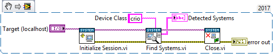

I'm using the LabVIEW Find Systems function and I want to know what are the acceptable values for the device class input.
The Find Systems VI is used to search the local network for NI Real-Time devices. An example of using this function is given below.
The device class input specifies the type of device for which you are searching. The accepted device strings are shown on the table below. To specify multiple classes, use a comma to separate the values.
DeviceString
PXI Controllerpxi
PXIe Controllerpxi
cRIO Controllercrio
CVS Controllercvs
Industrial Controllercvs
cFP Controllerfieldpoint
