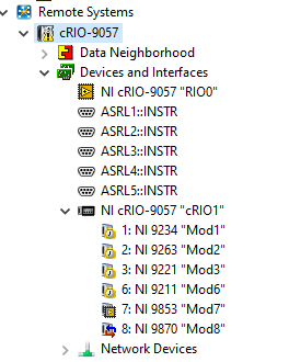

I have installed the required software to use a NI 987x module on my CompactRIO, but the COM ports are still missing in NI Measurement & Automation Explorer (NI MAX) or appearing under devices and interfaces rather than under the module specific tab.
Please refer to Real-Time Controllers and Real-Time Operating System Compatibility to find out what operating system your cRIO controller is running.
NI Linux RT target
For NI Linux RT target, the serial ports appear under Devices and Interfaces but not under the NI 987x module.
Phar Lap ETS or VxWorks target
For Pharlap ETS or VxWorks target, the serial ports appear under the NI 987x module.
