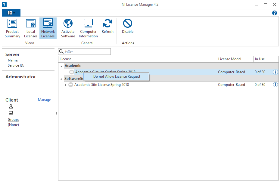

I am using NI Volume License Manager to manage license permissions. How can I stop clients from requesting permissions to specific NI software packages or modules?
If you have a Concurrent License, you can prevent a computer from using a specific network license using the option Do Not Allow License Request.
  1. Open NI License Manager on the client computer.
  2. To prevent using a specific network license, right-click on the product listed under a network license server and select Do Not Allow License Request. You can also select the product listed under a network license server and click Disable.
  1. If you need to access the license again, right-click on the blocked product and select Allow License Request or select the blocked product and click Enable
