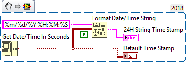

I use Get/Date Time VI to acquire time from the system. However I can obtain only 12-hour (AM/PM) time format. Is there any possibility to get 24-hour format timestamp?
To get 24-hour time format you can implement ​​​Format Date/Time String Function. As an outcome you will get 24-hour time string time stamp.
