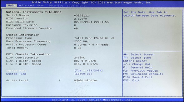

1. Press the Power button on the PXI chassis, then press Del on the keyboard repeatedly to enter the BIOS.
2. Switch tabs to Advanced and select Power/Wake Configuration as shown below.

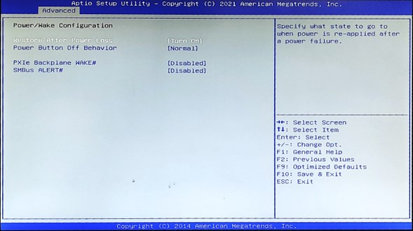

3. Select Restore After Power Loss and select Turn On as shown below.

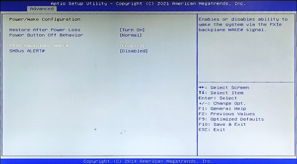

4. Select PXIe Backplane WAKE# and select Enabled as shown below.

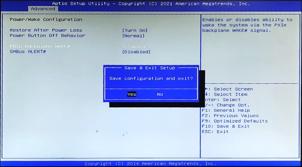

  1. Press F10 on the keyboard and select Yes to save the configuration and restart the controller as shown below.
