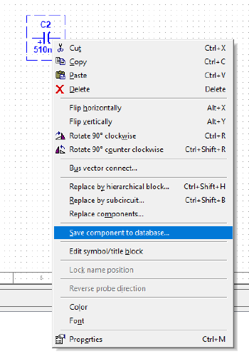

Adding components to a Database:
1. We can add components to the User Database to have a quick access to the parts of your project. To do this, right click in the component and select Save component to data base.
