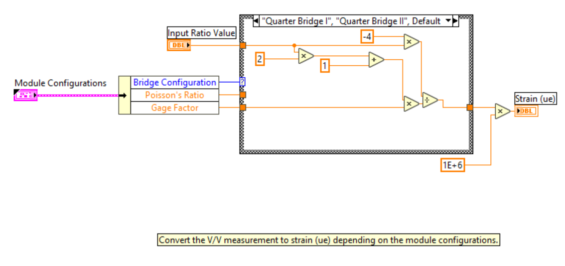

Finally, already processed data is then transformed into strain measurments at the Ratio to Microstrain (SubVI).vi, notice that the applied formula conversion depends on the bridge configuration. For example, the Quarter Bridge Case I and II are calculated using math Vi's as shown in figure 2.
Figure 2. Ratio to microstrain conversion for the Quarter Bridge I and II configuration.
