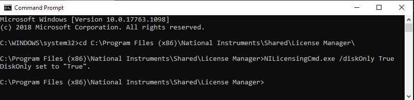

  • From NI License Manager 4.0 this function does not work, but you can achieve the same results using the following command in Windows Command Prompt:
  1. Open Windows Command Prompt
  2. Type in the following commands:
cd C:\Program Files (x86)\National Instruments\Shared\License Manager\
NILicensingCmd.exe /diskOnly True
You should see the DiskOnly set to "True" message as shown on the image below.
This will change the source of the ID to the disk serial number for both the NI License Manager and the generateComputerId.exe. Similarly, you can deactivate this option by setting the /diskOnly parameter False using the Command Prompt.

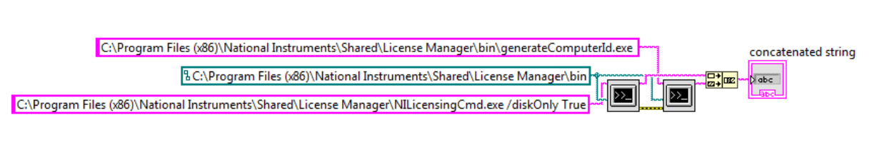

  • The Computer ID generation can also be achieved programmatically using LabVIEW. If you want the ID to be consistent, you can use the DiskOnly parameter to make the ID to be always based on the disk serial.
It may be necessary to reactivate some software if it was previously licensed under a different computer ID.
