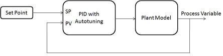

The PID Autotuning VI uses the Ziegler-Nichols tuning method. This is a heuristic method that will iterate the PID values until the system has reached a tuned state. The diagram below outlines the process used by the PID Autotuning VI:
The autotuning procedure is excited by the setpoint relay which steps the setpoint up or down. This will allow the controller to respond to changes and tune the system for an acceptable response. For more information about how this VI works, see the Product Manuals: LabVIEW PID and Fuzzy Logic Toolkit User Manual and the PID Autotuning VI Help page.
