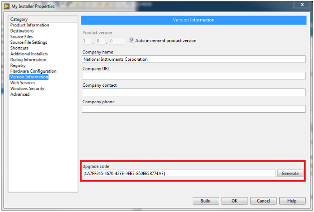

When I run my custom installer, I receive the message, "Cannot install: Higher version already installed" on my deployment computer. How do I fix this?
If you are getting the error trying to install an Add-on or a NI Toolkit, you can refer to Installing Multiple Versions of a LabVIEW Add-On or Module on the Same Computer. Otherwise, follow the next steps:
  1. In the Build Specification for your installer, go to Version Information tab.
  2. Click the Generate button next to the Upgrade code field.
  1. Then click the Build button to compile your installer.
  2. Run it on the deployment computer.
When you create a custom installer, LabVIEW generates a global unique identifier (GUID) to identify your program. This is how version numbers are checked when installing software to a new computer. If you copy your LabVIEW project from one directory to another, and then try to create a new installer from that project, the GUID will not update. Therefore, the target computer will not recognize the updated installer as a new piece of software and will not permit the installation.
