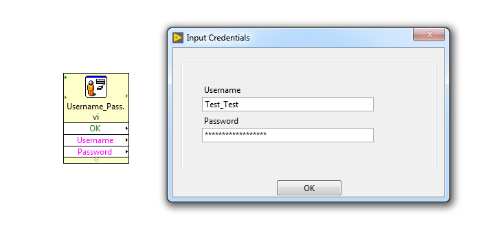

A valid workaround would be to first configure the Express VI with the input boxes you want, then:
  1. Right click the express VI >> Open Front Panel
  2. Enter Yes to the prompt of saving the express VI as a SubVI
  3. Navigate to the block diagram of the new SubVI
  4. Right click on the password string parameter >> Properties
  5. Set "Display Style" to password
Doing this will create a SubVI with the desired functionality.
