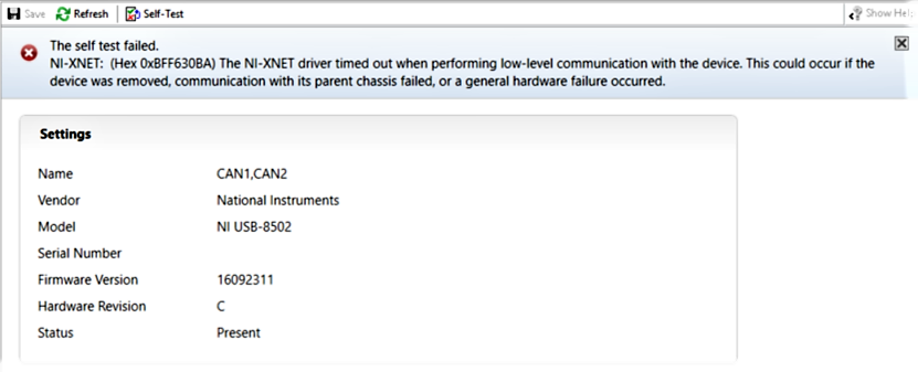

I am using a NI-XNET device and I can detect the device in NI MAX but I am seeing this error after performing a Self-Test:
NI-XNET:  (Hex 0xBFF630BA) The NI-XNET driver timed out when performing low-level communication with the device. This could occur if the device was removed, communication with its parent chassis failed, or a general hardware failure occurred.
  • Upgrade the NI-XNET driver to the latest compatible version.
  • Make sure the actual frame has same byte with the definition in database.
If you are using a PCI card:
  • it should be connected to a native PCI port. A bridge PCI port should not be used.
  • Remove all other PCI cards if you are using multiple PCI cards in the same desktop or industrial PC. It could be due to the limitation of the power supply.
  • Increase the PCI Timeout time in BIOS. You might need to refer to the user manual of the desktop for the steps.
If you are using a USB card:
  • Try to connect the card in a second USB port.
  • Check with your IT team that there isn't any block on your USB ports
If you are using a PXI/PXIe card:
  • There have been cases reported where a PXI hybrid-compatible module may fail self test in certain slots of a PXIe chassis. This may be due to the PCI/PCIe bridges used to connect PXI cards to the PXIe backplane of the chassis. Try using the module in a different slot to see if the error is still present. You can refer to the user manual of your specific chassis for more details on finding a slot on a different bridge.
  • For example, if the error occurs while the card is in slot 14 (which is located on the PCIe-PCI Bridge #3) of a PXIe-1084 chassis, you might try using the card in slot 2-7, which are all on PCIe-PCI Bridge #1.
If this issue happens to PXI/PXIe XNET card in MXI setup, try to change the PCIe to another PCIe slot of the motherboard, for example change the PCIe from x4 to x16 may help to resolve this issue.
