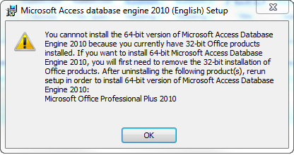

LabVIEW 64-bit installs the 64-bit Database Connectivity Toolkit starting with the 2019 release. This is compatible with the Microsoft Office 12.0 Access Database Engine OLEDB Provider, which is not installed with Windows by default.
You can obtain this provider by installing the External Link: Microsoft Access Database Engine 2010 Redistributable . Note you must first uninstall the 32-bit provider or uninstall the 32-bit Microsoft Office installation which contains this provider. Otherwise you may receive an error like the one shown below.
This error also occurs if you install a Database component with a different bitness compared to that of LabVIEW. The following examples show this:
