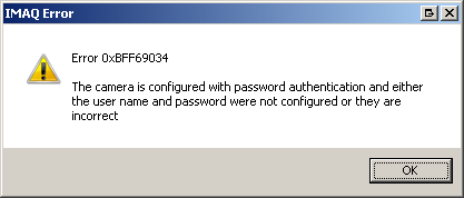

When I try to connect to an AXIS camera that is connected to a CompactRIO, I get the following Authentication Error:
The camera is configured with password authentication and either the user name and password were not configured or they are incorrect.
Error 0xBFF69034
On some AXIS cameras, the CompactRIO cannot properly authenticate as a valid network client. In order to connect, you must check the enable anonymous viewer login (no user name or password required)
