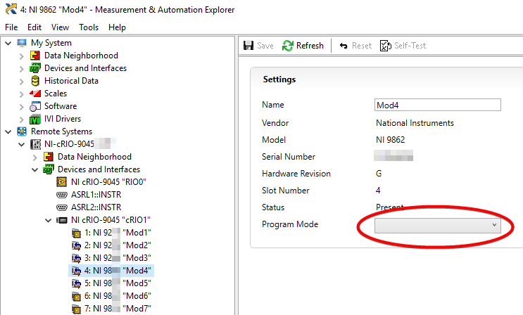

Adding an NI-914x EtherCAT CompactRIO chassis to our LabVIEW project renders the modules in the cRIO-904x unusable. They simply stop working. It happens right after adding the EtherCAT device and using "deploy" in the LabVIEW project. How to fix this?
This is a Known Issue in the NI-DAQmx device driver version 17.6 and 18.0. Find more information on this issue here: Deploying an EtherCAT Master Changes the Programming Modes on cRIO-904x to Real-Time Scan (ID 706379).
Basically, the modules' Program Mode needs to be set again. This can be done either manually in NI Measurement & Automation Explorer (NI MAX), or programmatically using LabVIEW code.
  • To reset the Program Mode manually:
    1. Open NI MAX
    2. Navigate to Remote Systems » <your cRIO controller> » Devices and Interfaces » <your cRIO chassis>
    3. For every module present, click its entry on the left panel, then go to the right panel, and select a Program Mode. Click Save after selecting it.

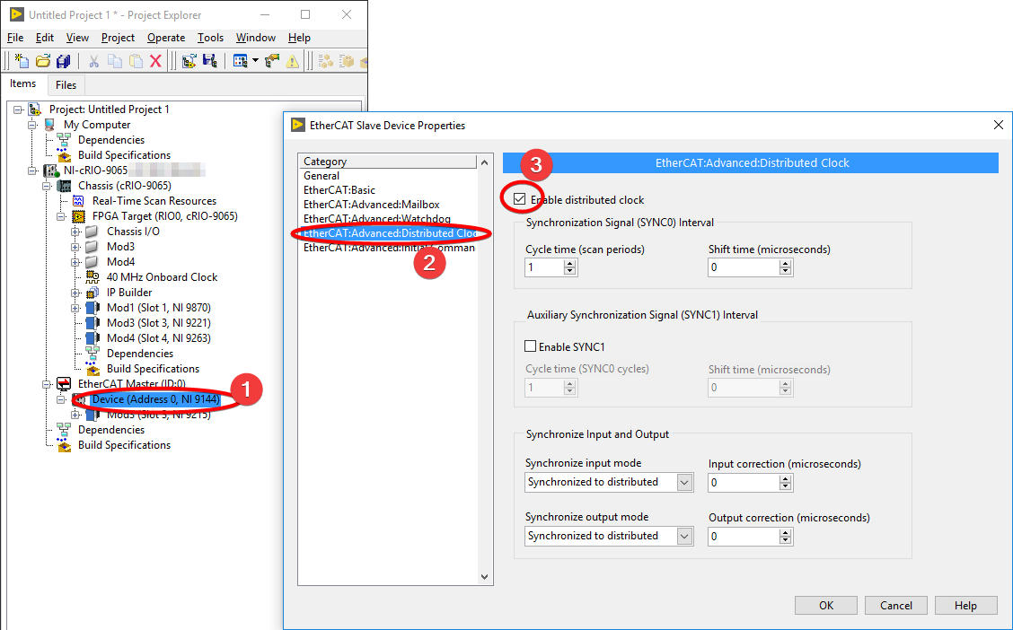

Another possible issue could be a disabled distributed clock on the slave device. To enable it, find the EtherCAT device in your LabVIEW project, right-click it and click Properties. Then navigate to EtherCAT:Advanced:Distributed Clock, check Enable distributed clock, and click OK:
